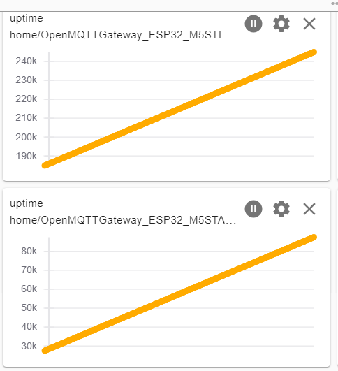

The first results are encouraging:
The modifications are now integrated into the development branch.
