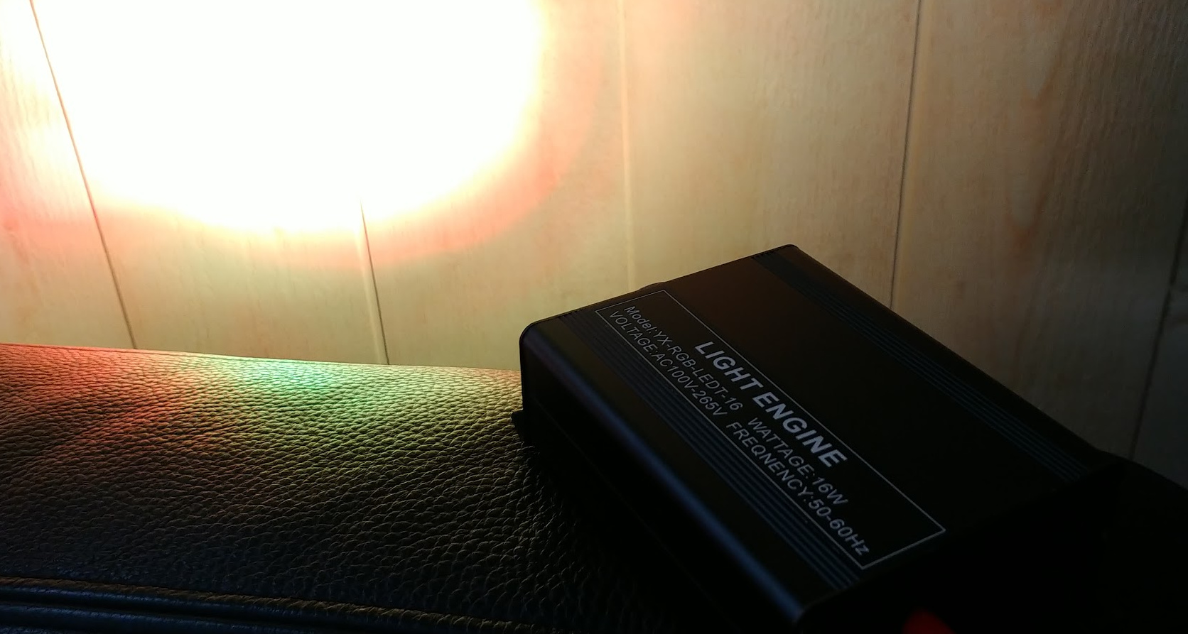

Here is some infos about an OMG compatible device, a powerfull 433mhz light engine. It can diffuse an ambient light or can be connected to an optical fiber.
It can generate various colors.
Powered by a 220V It has an ON OFF switch and a 433mhz remote.
The antenna is just a simple wire going out the device.
Note that the 220V doesn’t seem to be at european norms contrary to the CE logo that appears on the box.

Some pictures:
Device
