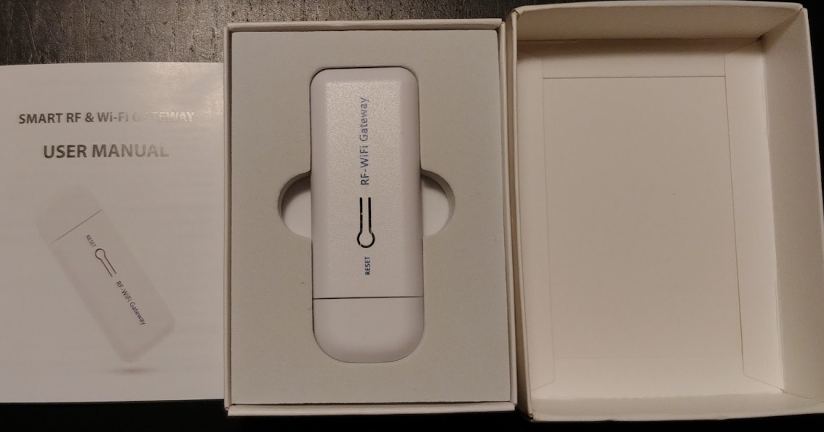

Nevertheless this ESP8266 board with an integrated RF receiver is quite interesting and fully compatible with OpenMQTTGateway.

Looking at the u2 chip (CMT2210LC), its a dedicated OOK receiver which is kinda nice because it off-loads the decoding work from the ESP.
When you flashed your image, it does not configure the chip to decode. So, it stayed in pass-through mode. This means you were not taking advantage of the power of this chip’s decoding features and left all the work for the ESP. This is a powerful little chip to have on the board if you know how to use it… This can allow your ESP to be heavily tasked without losing RF packets.
This is really not a bad price when you consider most ESP8266 boards and 433Mhz superheterodyne receivers (single quantities) will cost about $6 each. Then you have to connect everything, power it, and case it.
