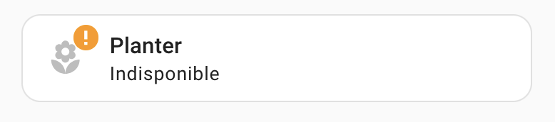

This is confusing because we have the log
N: Connected to broker
However in homeassistant dashboard we have
All other entities used by homeassistant, mainly mqtt integration, have no issues after the server stack restart :face_with_monocle:
