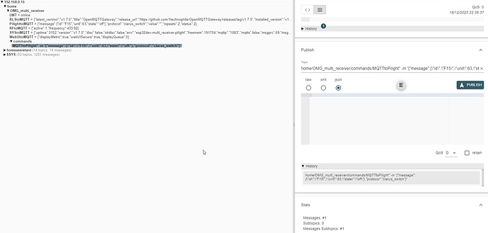

I send the commands on MQTT explorer publish section.
I send your code:
home/OMG_multi_receiver/commands/MQTTtoPilight" -m '{"message":{\"id\":\"F15\",\"unit\":63,\"state\":\"off\"},"protocol":"clarus_switch"}'
And shows this on explorer and nothing happen on the fan:
Ok, the Publish section is split into two main areas, the topic and command message content.
Try it like this, as the examples given in the docs are the combined Mosquitto CLI sommands.
You should then also see a commands sub topic pop up on the left in your gateway’s section. Expanding it fully will reveal the command which was actually sent.

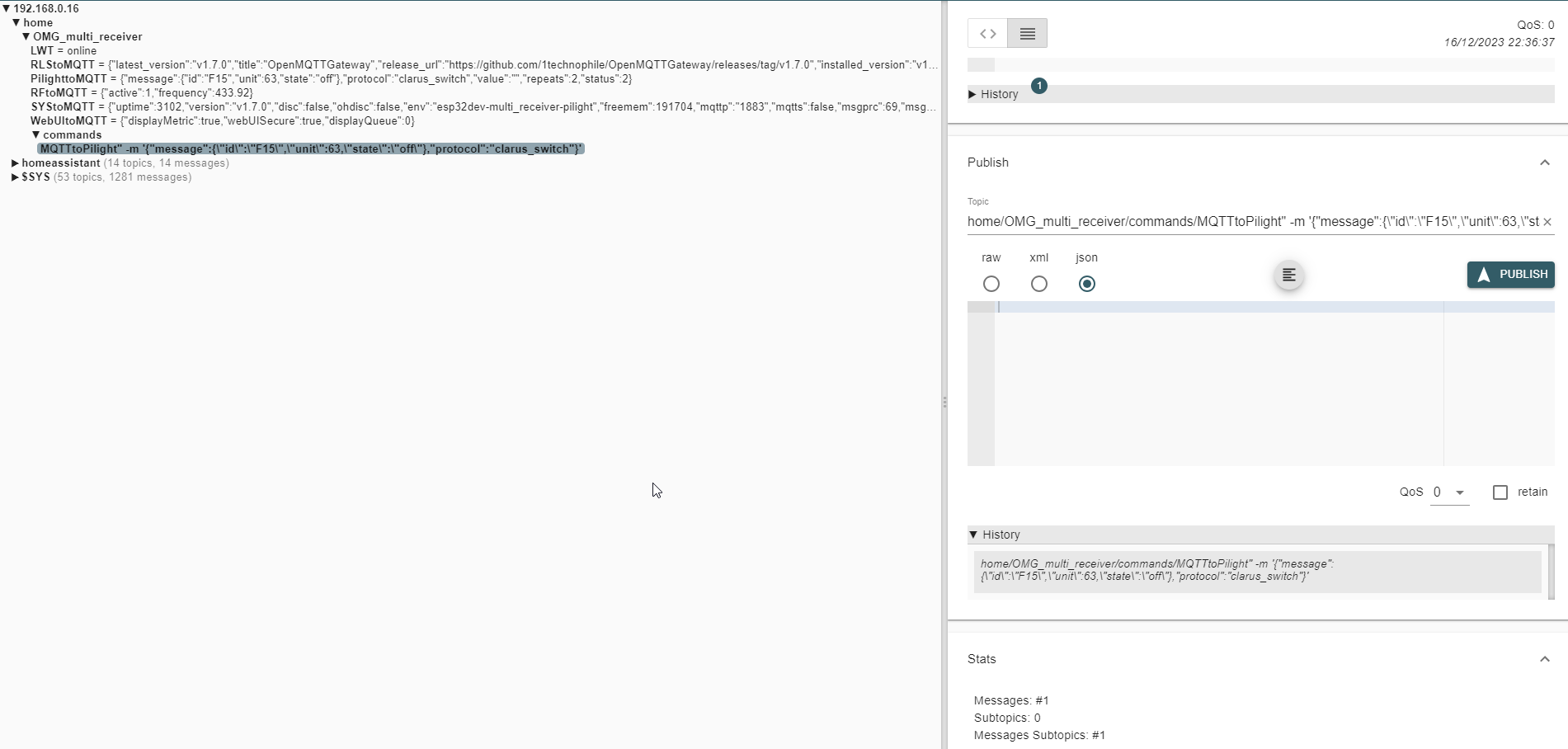

Ok, send but nothing happen:
And without the escaped nested JSON in the message?
{"message":{"id":"F15","unit":63,"state":"off"},"protocol":"clarus_switch"}
same, nothing and shows this at the left:

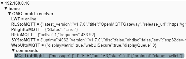

When I send these commands:
{"message": {\"id\":\"F15\",\"unit\":63,\"state\":\"off\"},"protocol":"clarus_switch","value":"","repeats":2,"status":2}
{"message":{"id":"F15","unit":63,"state":"off"},"protocol":"clarus_switch","value":"","repeats":2,"status":2}
PilighttoMQTT shows an error :melting_face::
{“Status”: “Error”}
