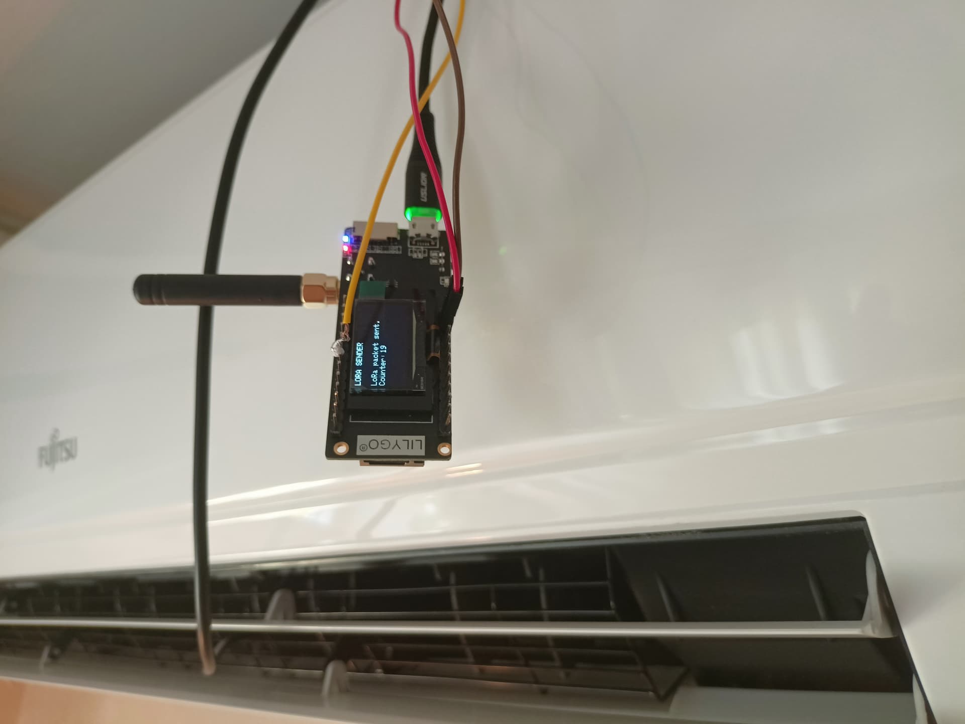

Measuring for fun, the air temperature that my split air conditioner unit delivers through a dallas sensor:

I get board info in mqtt, but I don’t get any signals, even though I should. Also the display, expectedly, doesn’t work. However, in your picture the display works, so I assume you have done something different?
