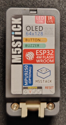

Hello, i need some help because i have this ESP32-WROOM-32 and i can`t get it to flash and work… i really want to make it work at least to the .py file part where i have to upload it with the MuEditor
i use the ESP32 FLASH DOWNLOAD TOOL V3.9.8
and after i do this nothin happens, i press the left side button that is reset and nothing, my M5 has only 2 buttons and the other one is on the right i think its a button A, it has OLED screen, looks something like this
please someone help
Welcome @Titas_Sarkus
To be honest, I’m not quite sure which .py file part you are talking about - are you possibly getting mixed up between OpenMQTTGateway (for ESP32/ESP8266) and Theengs Gateway (for Windows, Linxux …)?
For your M5Stick you can upload the esp32-m5stick-ble binary, easiest through the web upload at
Or did I completely misunderstand what your issue is? :slight_smile:
