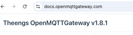

Also, I couldn’t figure out a way to determine the current firmware version from the Web UI
Indeed Atoms3u is not supported. Contributions to add the board support are welcome.
The firmware version is available on top of the page:
