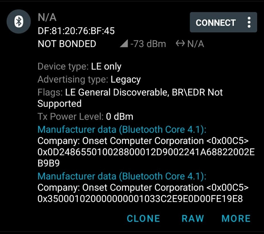

I’m trying to decode packets from hobo mx802 (conductivity/temperature/depth), sensor, but it sends 2 separate manufacturerdata packets, what does that mean? OMQ only sees one? IS it possible to get two manufacturerdata packets in OMG?
I caught some packets:

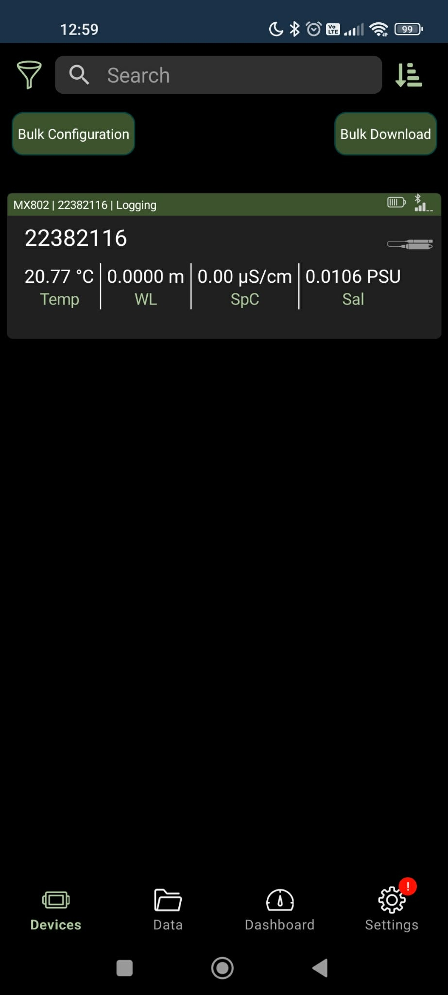

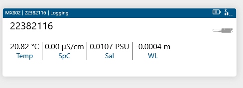

i took a screenshot of the hobo app and nrf connect
same packet with app screenshot
c5000d248655010028800012e2002241a62062002e3812
c5000d248655010028800012d9002241a68822002eb9b9
same time from pc app
N: [ OMG->MQTT ] topic: home/OMG_s3_ant/BTtoMQTT/DF812076BF45 msg: {“id”:“DF:81:20:76:BF:45”,“mac_type”:1,“adv_type”:0,“manufacturerdata”:“c5000d248655010028820012d9002241a68822002eb9b9”,“rssi”:-88,“txpower”:0}

the packages are sent in two parts manufacturedata 1 and 2
no. 2 starts with 0D24 and contains temperature and water level and the 1 package contains conductivity
