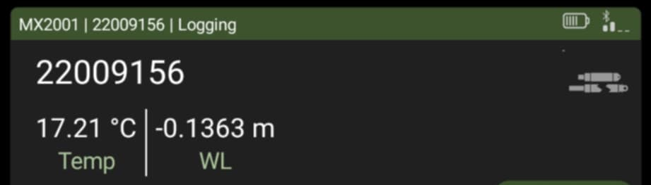

It seems that temperature is still important, I use this sensor in the winter and the temperature goes below zero and it’s bad when the sensor freezes over.
I tried to find the temperature relationship but I guess I’m doing something wrong :frowning:
maybe the hex values ​​are in fahrenheit scale not celsius,because it is made in the USA
did linear regression analyze to hex values and there is something in 3 groups
some hex values are ~4600 most are ~37000 and some are ~~53000
when filter out values ~37000 it is linear
I also tested the battery voltages and found the battery value on the package
4 first blue numbers are temp and last 4 blue numbers are battery values

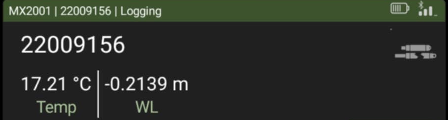

c500073fd54f0106240000000800903c0265d078b6ba  temp 19,11   voltage 1,7v   bat indicator 0 logger stopped
c500073fd54f0106240000000800123c0268283dd1ba  temp 19,11   voltage 1,7v   bat indicator 0
c500073fd54f0106240000000800123c0268283dd1ba  temp 19,11   voltage 2,0v   bat indicator 1
c500073fd54f0106240200000800d23c027000f4aab9               voltage 2,2v   bat indicator 2
c500073fd54f0106240200000800523b027c0047f5b9  temp 19,21   voltage 2,4v   bat indicator 3
c500073fd54f0106240200000800d23b0288004e19b8  temp 19,21   voltage 2,6v   bat indicator 4
c500073fd54f0106240000000800523b0295c0135a39  temp 19,21   voltage 2,9v   bat indicator 5
c500073fd54f0106240200000800123b029960e3ec39  temp 19,21   voltage 3,0v   bat indicator 6
c500073fd54f0106240000000800123b02a1d0d310ba  temp 19,21   voltage 3,15v  bat indicator 6
c500073fd54f0106240200000800d24f02a2c0c0a6ba  temp 17,30   voltage 3,3v   bat indicator 6
c500073fd54f0106240000000800d27002a200cf1e39  temp 17,30   voltage 3,4v   bat indicator 6
c500073fd54f0106240000000800d27002a200cf1e39  temp 17,30   voltage 3,5v   bat indicator 6
c500073fd54f0106240200000800529102a2f03a45ba  temp 10,96   voltage 3,1v   bat indicator 6

Is it possible to show negative water level also ?
The sensor can be calibrated to different levels and if it is calibrated to a higher level and the water level drops, it will start transmitting a minus sign indicating water level and then decoder is showing “HOBOMX2001”,“type”:“UNIQ”,“lvl_cm”:null,“lvl_in”:null} .
I’d advise agains trying to implement this in the decoder, as it could likely also falsify current correct level publishings. Unless the device actually sends negative level values when the calibration 0 level has been undershot.
I assume though, that such transformation should be better done at the calibration stage or by a calculation in the controller, or do you have negative level value raw data examples?
How are you intending to implement such theoretical negative levels?
Does the native app display negative level values?
Yes app is showing negative WL(waterlevel)…
The logger works so that when the logger is started, the water level becomes 0 regardless of whether the logger is in the water or on dry land. And if the logger was initially in the water and then the water level drops, it will start showing a negative level.
