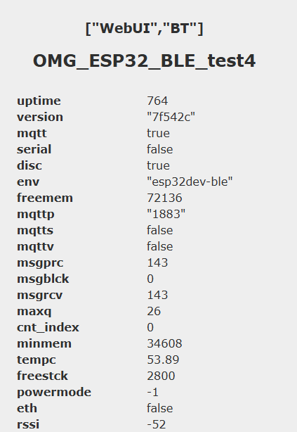

strange , still same , tryd with 2 versions… “lvl_cm”:null,“lvl_in”:null}
uptime
103
version
v1.8.1
mqtt
true
serial
false
disc
true
ohdisc
false
env
esp32dev-ble
uptime
55
version
7f542c
mqtt
true
serial
false
disc
true
env
esp32dev-ble

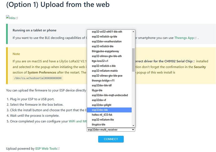

Can you try with a pre-built binary of the development test builds?
One gateway, many technologies: MQTT gateway for ESP8266 or ESP32 with bidirectional 433mhz/315mhz/868mhz, Infrared communications, BLE, LoRa, beacons detection, mi flora / mi jia / LYWSD02/ Mi Scale compatibility, SMS & LORA.
and I choose from the list esp32dev-ble?
DigiH
March 27, 2025, 1:32pm
48
Correct, assuming this was also the environment you previously used to build.

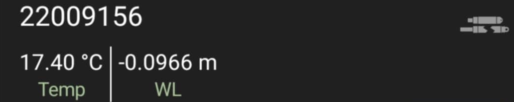

app is showing negatine
packet is coming ,but gateway dont decode if its negative
and I tried putting the sensor deeper in the water, as soon as positive numbers come in, the gateway starts showing them too:
N: [ OMG->MQTT ] topic: home/OMG_ESP32_BLE_test4/BTtoMQTT/EDD8E2A2CC0A msg: {“id”:“ED:D8:E2:A2:CC:0A”,“mac_type”:1,“adv_type”:0,“manufacturerdata”:“c5000744d54f0106240000000800124e028a40cb8f3c”,“rssi”:-86,“txpower”:0,“brand”:“Onset”,“model”:“Hobo Water Level Sensor”,“model_id”:“HOBOMX2001”,“type”:“UNIQ”,“lvl_cm”:1.755297,“lvl_in”:0.691062}
but as long as it is negative it show this “null”.

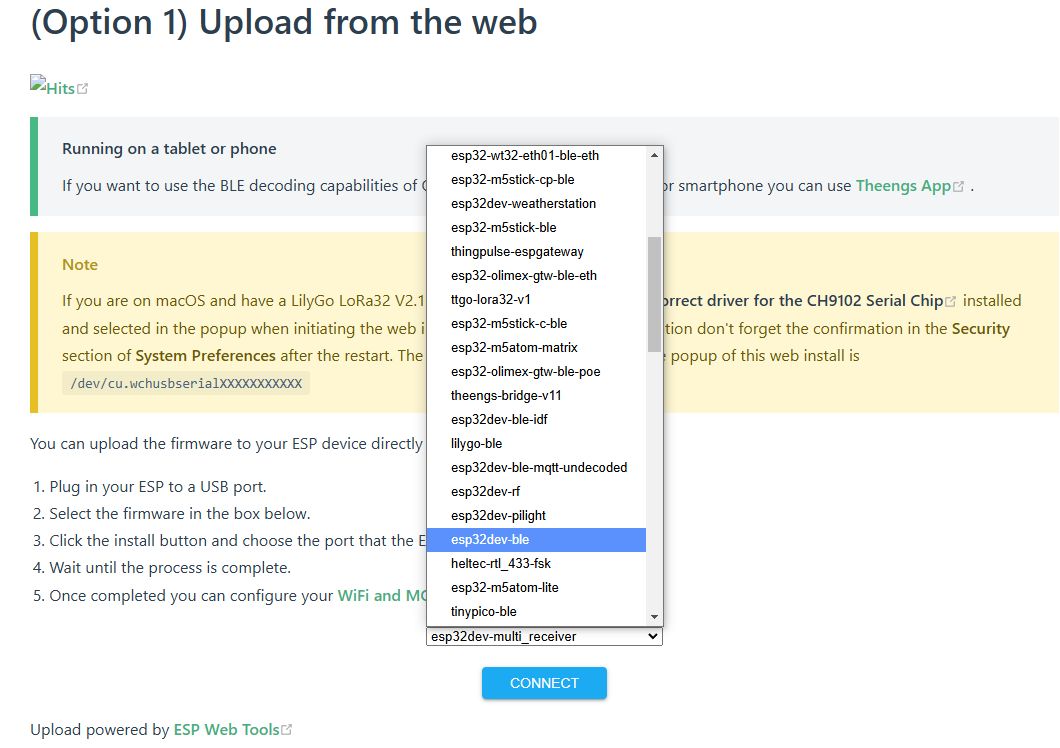

DigiH
March 27, 2025, 4:06pm
57
@mortenx
Can you reload the development test upload page, so that it shows SHA: e719bb at the top of the page, then upload the esp32dev-ble binary from that build.
