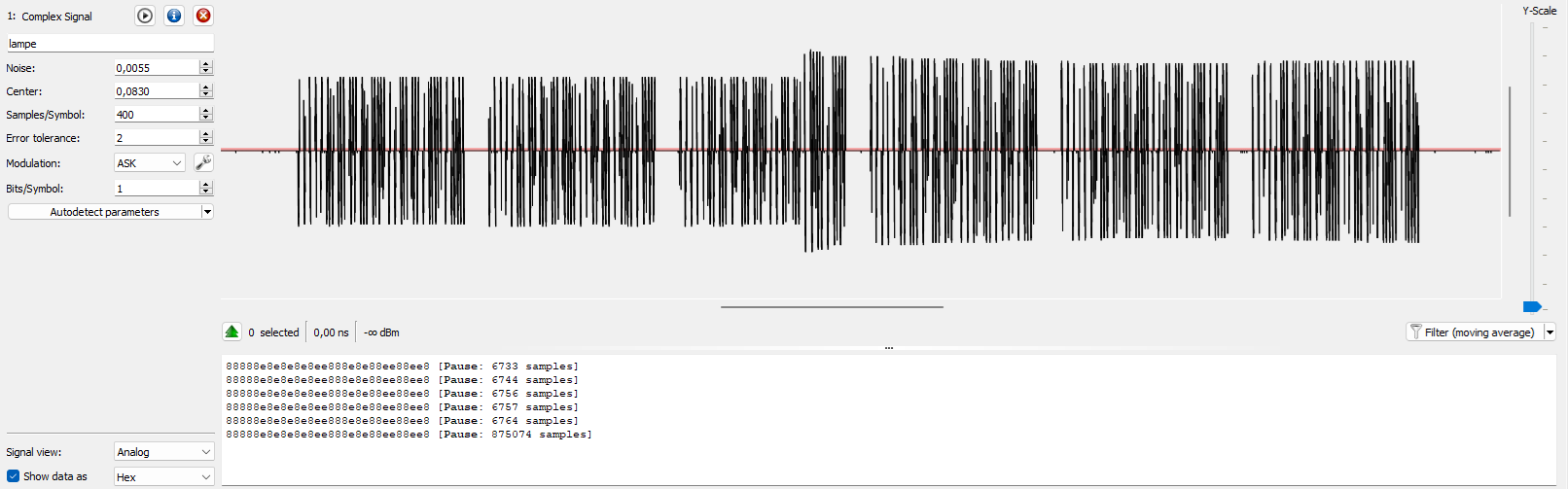

I’m trying to control my 433.92 MHz ceiling fan from Home Assistant using OpenMQTTGateway on an ESP32 + CC1101.
The fan’s remote control is not recognized by the built-in protocols, so I’m looking for advice on how to proceed.

output to triq.org for analysis - Inspected the signal in Universal Radio Hacker → can see pulses with a preamble and data, but the structure doesn’t seem to match the
rtl_433
analysis - Not sure if there’s a unique ID in the signal

Example raw frame (Turn lamp on/off) from Universal Radio Hacker
