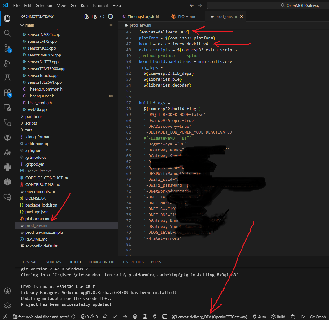

I don’t know the configuration required to achieve what you want, but what I did with my board (az-delivery dev kit, 4, which is not listed) was to create a new environment and customise the build flags and code to create firmware that is 100% synchronised with my specific board/context. I hope this helps!
Thanks, seems like I need to learn a lot more about PlatformIO
