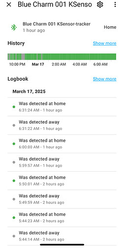

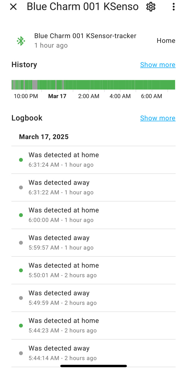

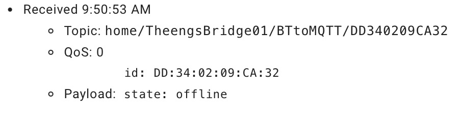

However, still, every 40 minutes / 1 hour I see the change to Away status with the corresponding message in the topic:
{"id":"DD:34:02:09:CA:32","state":"offline"}

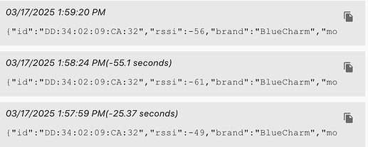

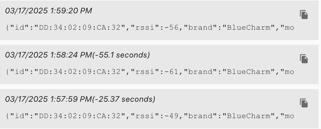

The Home Assistant status history looks like so, while the tracker is stationary. Any advise is appreciated.

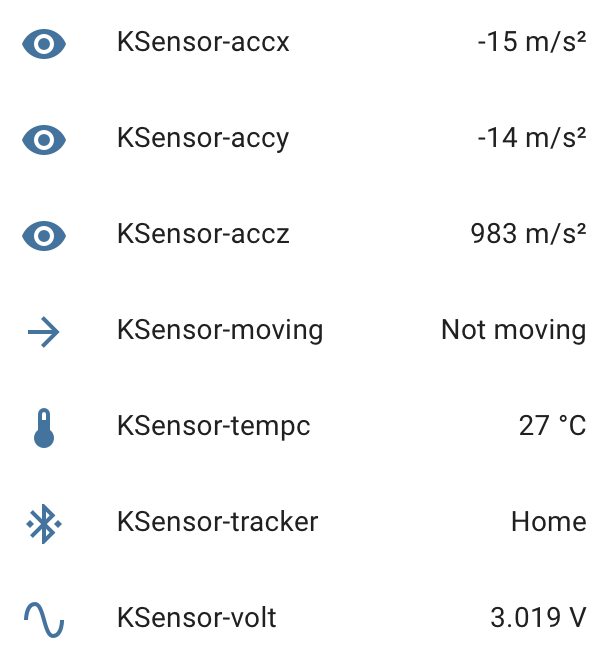

One relevant observation is that those Away events may be related to the intervals when no motion is detected. If I switch off accelerometer in the tracker device, I no longer see any MQTT messages and the status is permanently away. This leads to the question - can this device reliably work as a tracker in KSensor protocol.
