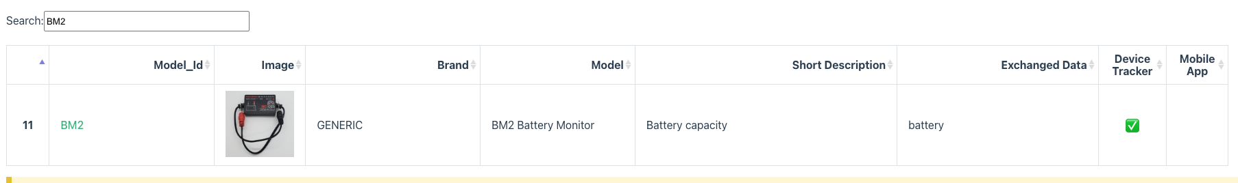

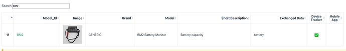

Also I have a BM2 that it never finds, but it comes up in the section were you can black list stuff
It will not continue to send data permanently, you could try to let it for several hours and check your history in MQTT explorer. Mine send data every hour.
BM2 is not compatible with the Theengs App
