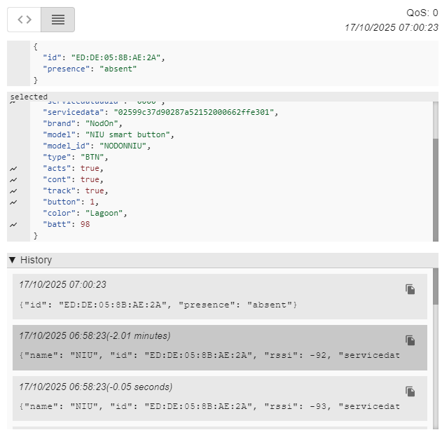

screenshot : a message “absent” in MQTT after a certain time, but other different button messages after the last press
Good that you found a solution and addressed this in Jeedom.
Yes, this is the tracker away message. I will take the tracker functionality out however, as it doesn’t make sense for devices which don’t send regular broadcasts.
