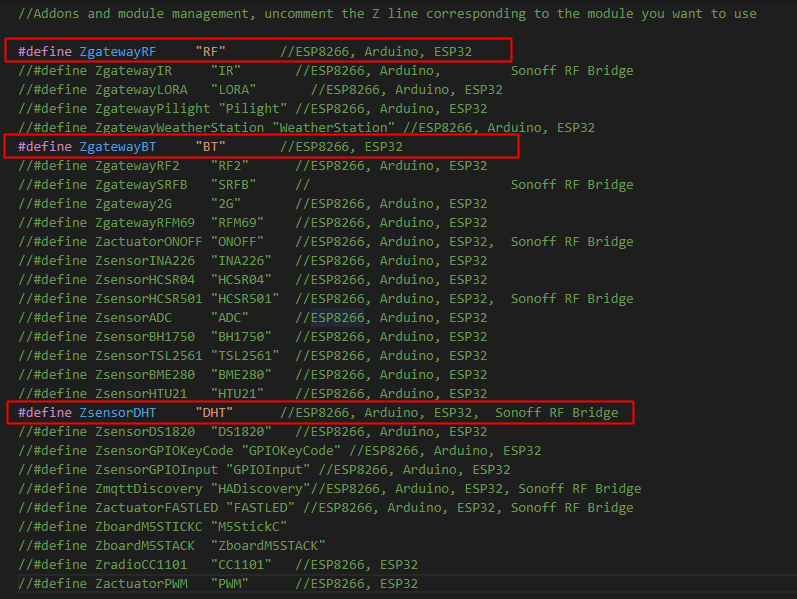

This is the configuration on User_config.h:
and:
