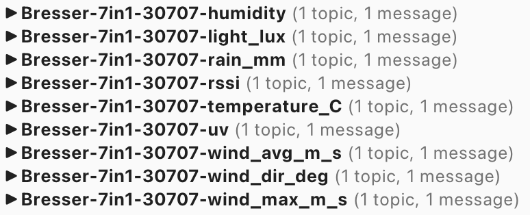

My second problem is that I would like the Device received via OpenMQTTGateway to be the same device in Home Assistant as it was when received via the rtl_433 add-on. I believe that to this end, OpenMQTTGateway should just overwrite the discovery information that was provided by the rtl_433 Auto-Discovery Add-On. However: The HA Addon presented a bunch of topics under homeassistant/sensor/Bresser-7in1-30707 as follows:

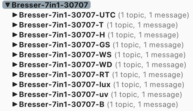

Whereas OpenMQTTGateway provides a flat list of topics under homeassistant/sensor as follows:

Hello,
You could just deactivate auto discovery in HA, this way newly detected devices will not be created.
We are not using the same way of structuring the data as the RTL_433 Addon so this would require to modify the OpenMQTTGateway code.
