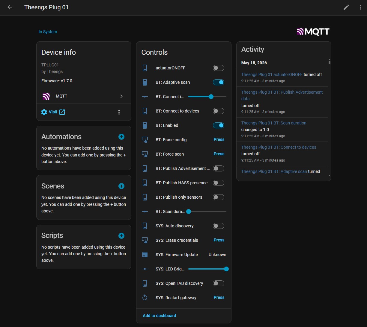

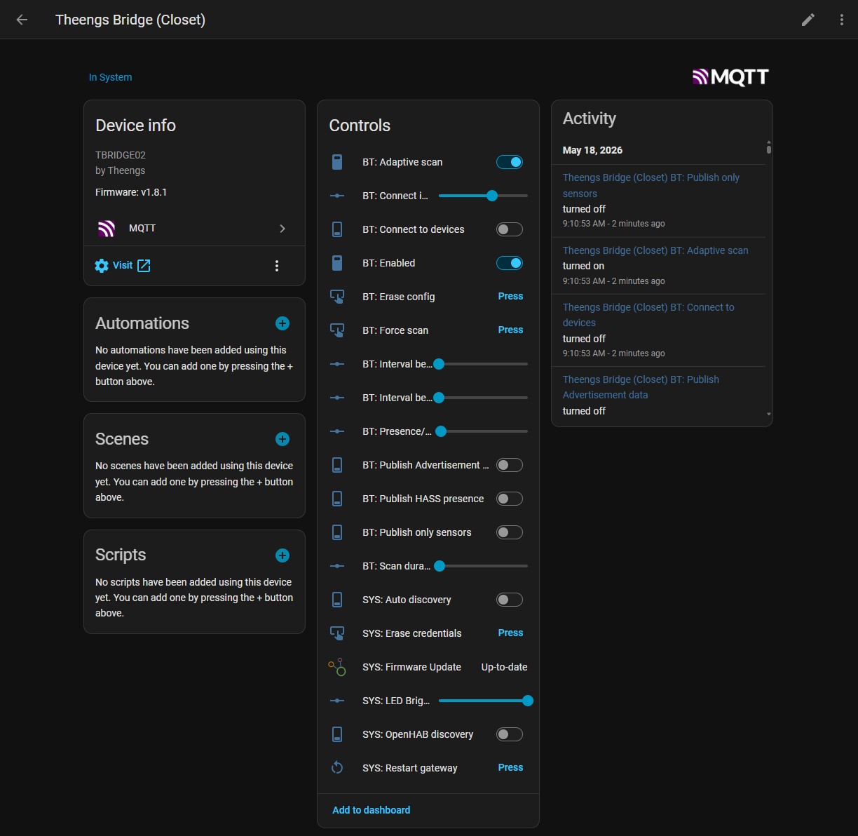

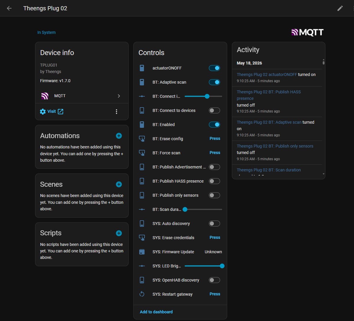

Hello,
Could you share a screenshot of your gateway parameters from the HA Settings → Devices ?
Here are the screen shots for each of the OMG gateways
