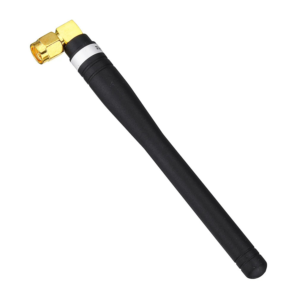

BUT now, I am getting information from all my sensors :slight_smile:
Thanks for the tip with antenna!

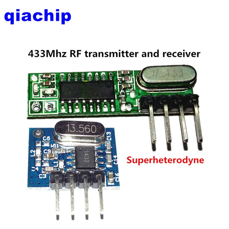

I found this little kit, for 2$ worth to try

I got the small one (Ali was fast this time), cut of the pigtail and soldered directly, also with GND found nearby.
First impression that definitely improved sensitivity, at least receiving what haven’t before, will be watching…
Sounds good, thanks for the feedback :slightly_smiling_face:
I think I’ll order this one and compare results with my DIY antenna. Stay tuned.
