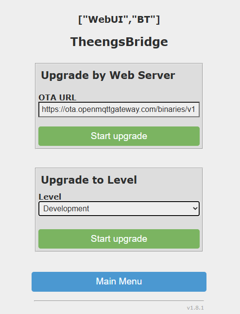

Morning, hopefully I am just being simple lol. I have the TheengsBridge and I want to get a development build on it. On the WebUI i set the Upgrade level to Development:-
but when it upgrades it is still version 1.81. Do I also need to switch the OTA URL? and if so is there one for dev builds?

I have reproduced the issue and will investigate what’s going on.
In the meantime I would advise to use the development portal with an USB cable:

If you have a TBRIDGE02, choose theengs-bridge-v11
