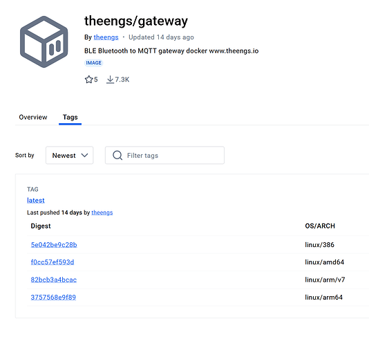

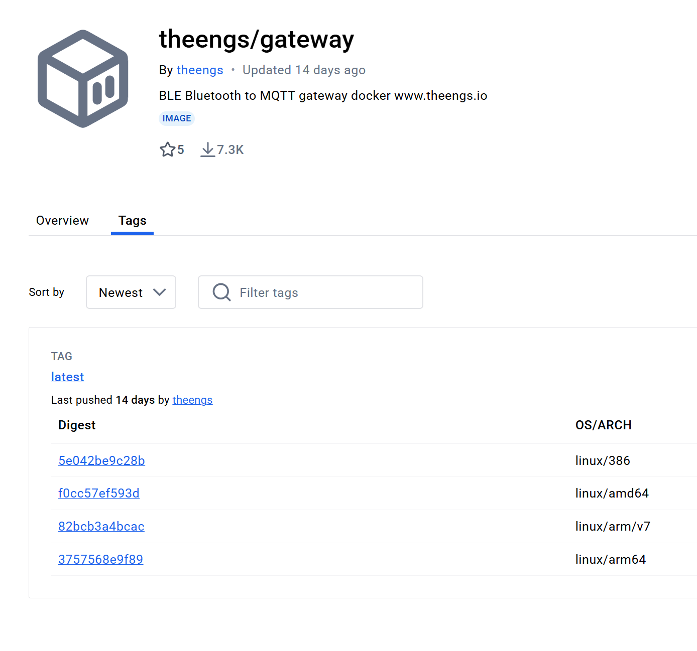

As TheengsGateway Docker v1.5.0.2 has only been released very recently, can you see if v1.4.0.1 is still available. Your WS02/WS08 was already available in that version.
Hi!
Unfortunately there is only one version - ‘latest’

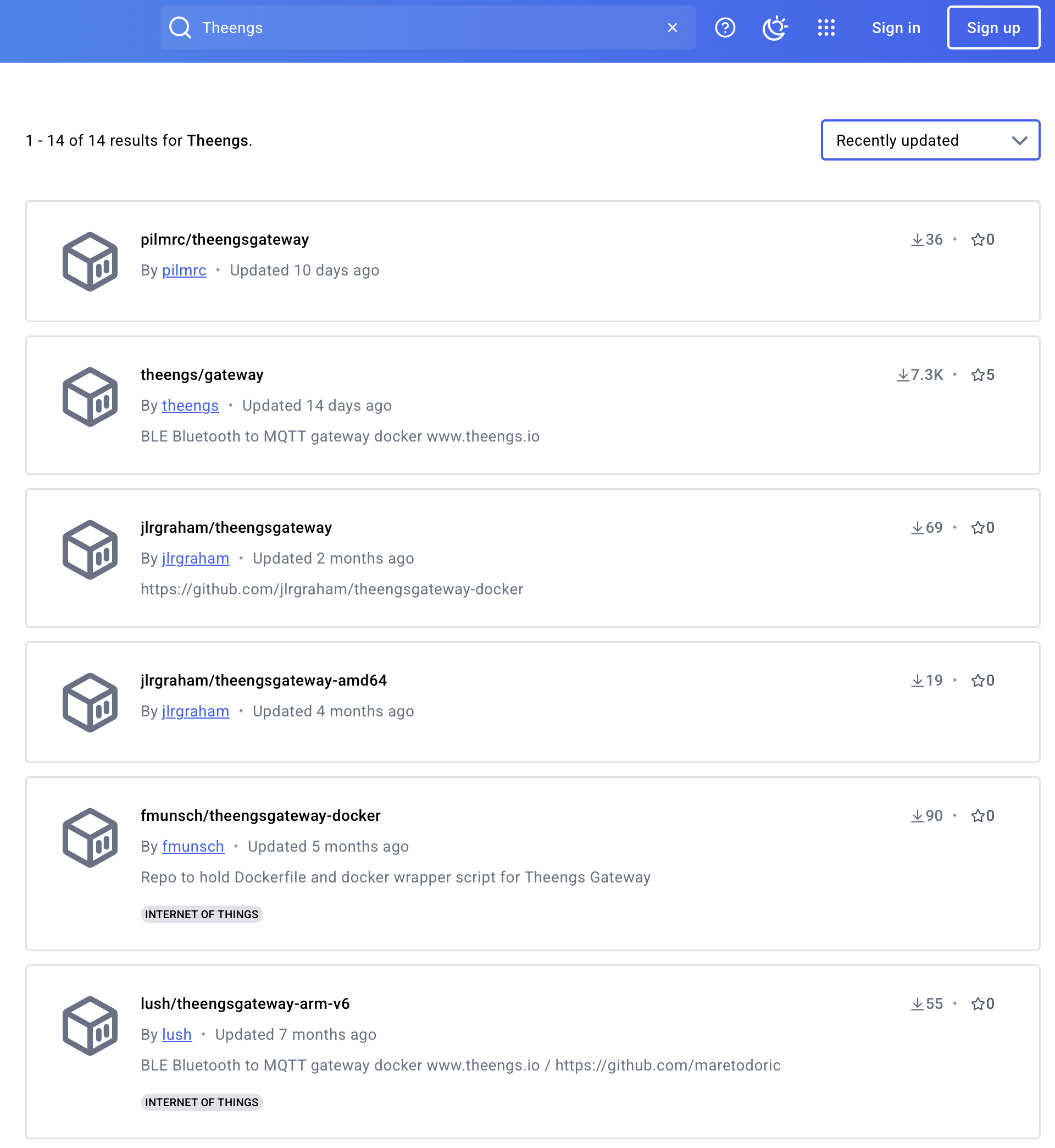

Not necessarily the preferred way, but when you search for Theengs on Docker Hub you will also find several other Docker images from Theengs Gateway :wink:
Sorted by recently Updated, you might want to try on of these, just to see if they might be have differently to our current container.
Let us know how you get on
I prefer to use a Docker image from the official developer, but at least this one is working:
fmunsch/theengsgateway-docker:1.5.0.1
