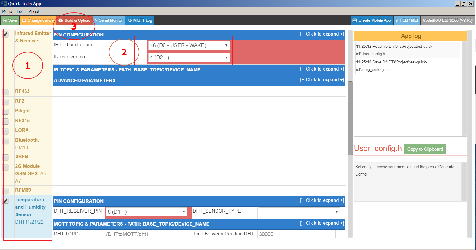

Quick start
  1. Create new project
  2. Choose device
    3. Choose module (1), setup PIN on device as require (2), Build & Upload (3)
  3. Your device will be running now. Connect to device wifi, Enter 192.168.4.1 in browser, set Wifi device connect to & MQTT server
  1. Open Serial monitor and MQTT log to see data. Now MQTT data from sensors send through MQTT, you could also send MQTT data to IR gateway. Open Node-red and setup a flow to control device through MQTT
