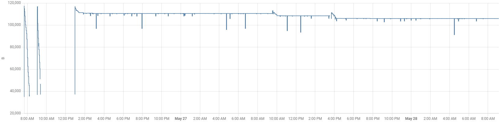

The graph above showed the rapid decline I was getting back on the 25th (localtime). The one between 3 and 6 PM would have included a WiFi/Internet dropout, but it seems like the lockup is under 40,000 Bytes. What would need that much?
here’s a couple of the SYStoMQTT messages from MQTT Exporer, just before and after I did the re-build, but I’m not sure how I can go back to the earlier crashes.
{"uptime":1210,"UTCtime":"2023-05-26T23:52:26Z","version":"version_tag","discovery":true,"env":"lilygo-rtl_433","freemem":109884,"mqttport":"1883","mqttsecure":false,"minfreemem":48324,"tempc":53.33333,"freestack":3132,"rssi":-51,"SSID":"paddys_tavern","BSSID":"0C:0E:76:AC:37:FF","ip":"192.168.1.8","mac":"D4:D4:DA:82:F1:74","actRec":3,"mhz":433.92,"RTLRssiThresh":-90,"RTLRssi":-105,"RTLAVGRssi":-99,"RTLCnt":1629,"RTLOOKThresh":15,"modules":["LilyGo_SSD1306","WebUI","rtl_433"]}
{"uptime":10,"UTCtime":"1970-01-01T00:00:10Z","version":"version_tag","discovery":true,"env":"lilygo-rtl_433","freemem":110668,"mqttport":"1883","mqttsecure":false,"minfreemem":106400,"tempc":53.33333,"freestack":5996,"rssi":-53,"SSID":"paddys_tavern","BSSID":"0C:0E:76:AC:37:FF","ip":"192.168.1.8","mac":"D4:D4:DA:82:F1:74","actRec":3,"mhz":433.92,"RTLRssiThresh":-82,"RTLRssi":-99,"RTLAVGRssi":0,"RTLCnt":1,"RTLOOKThresh":15,"modules":["LilyGo_SSD1306","WebUI","rtl_433"]}
________________ Rebuild with UTC time _________________
{"uptime":73944,"version":"version_tag","discovery":false,"env":"lilygo-rtl_433","freemem":110576,"mqttport":"1883","mqttsecure":false,"minfreemem":32228,"tempc":53.33333,"freestack":3132,"rssi":-54,"SSID":"paddys_tavern","BSSID":"0C:0E:76:AC:37:FF","ip":"192.168.1.8","mac":"D4:D4:DA:82:F1:74","actRec":3,"mhz":433.92,"RTLRssiThresh":-89,"RTLRssi":-90,"RTLAVGRssi":-98,"RTLCnt":104056,"RTLOOKThresh":15,"modules":["LilyGo_SSD1306","WebUI","rtl_433"]}
