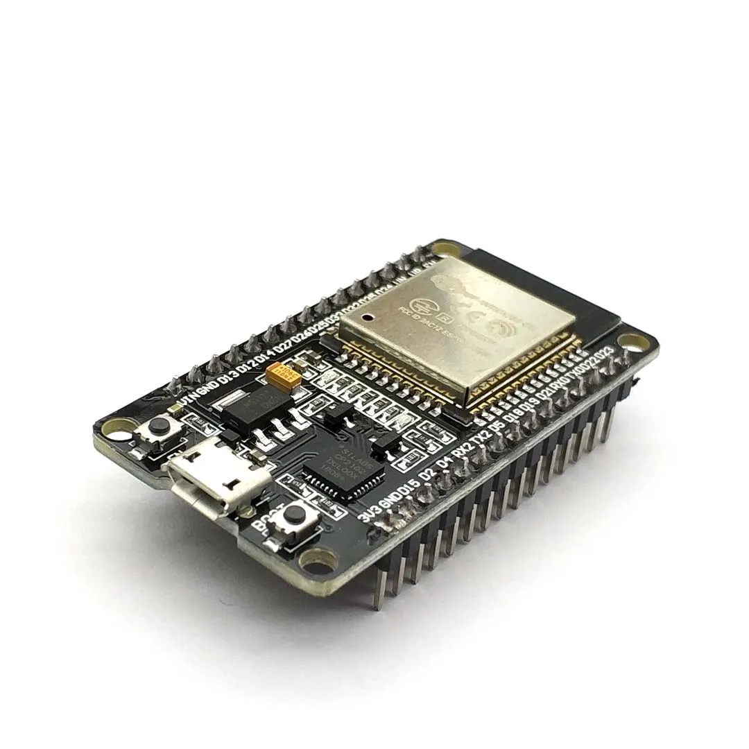

Yes you can, regarding hardware the easier is to buy a barebone ESP32, links there:
You don’t need an HM10 if you buy an ESP32.
The HM10 is just used to add the bluetooth function to an ESP8266 or an arduino.
So I can just feed power/ground (or micro usb) to this unit and install OMG?
This one being even cheaper, can you confirm if it’s equivalent to the above/recommended unit?

will go with the suggested model,
